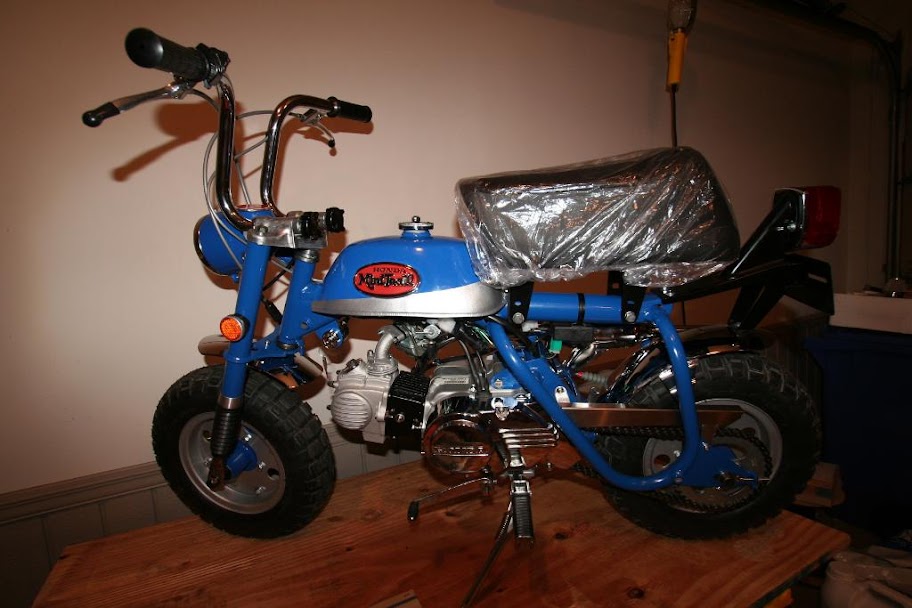

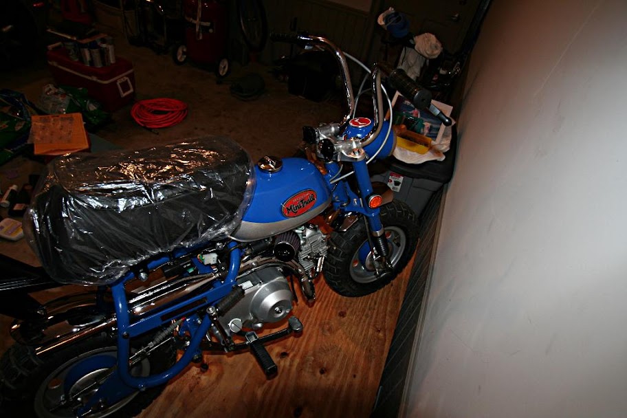

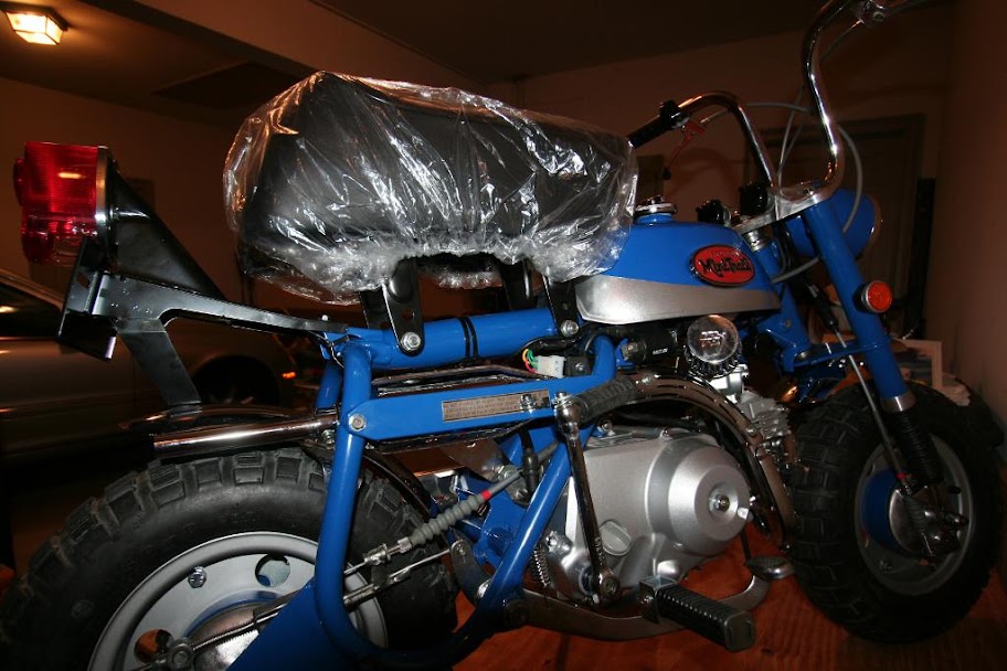

After working every night this week, and two back to back 12 hour weekend sessions, I finally got to put gas it it and give the engine a try. She fired on about the 5th or 6th stab. I'm not ready to call it finished yet. The lights didn't work, the chain guard rubs a little, the headlight cup needs some work, and the jetting needs some fine tuning, but....I did terrorize the neighborhood tonight at dusk LOL. OK, I made a couple of 4th gear runs to the end of the block and didn't frighten anyone but myself - running without lights.
I'd post some more photos and build details, but my back and feet ache from standing on concrete for two days. I'll get the Mini out in the sunshine and post the details one day when it's done. Thanks for reading.
BTW, I know that purists will not like the K1 fender and headlight emblem or Lifan engine. Those things will be put right one day when the oportunity presents itself. For now, let's just be happy that another hard tale is SAVED!!!

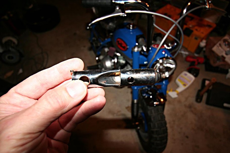

The Minigunz looks like the way to go and thanks for the feedback. On the home from work tonight, I began thinking about the exhaust issue, and I remembered that my little brothers used to pull the stingers out of theirs, just because it sounded better. I pulled mine out and ran the mini a couple of times around the hood. All of the stumbling was gone, and it felt like it had about 30-40% more power. It wasn't really too loud, especially after the neighbors are used to hearing me fire up the Duc, but I didn't care for the look. Examining the stinger and the little pinpoint opening on one end, it didn't take a rocket scientist to figure out that it must be choking the life out of the 72cc motor, and I bet the 50 too. So, out with the cutting wheel. Installed the stinger and man, still pretty quiet, motor runs very smooth, and has plenty of power. In fact I really need to gear up, because shockingly it pulled my 225 lb ass up the steep driveway in third gear. OK, now way under geared.
The stingerectomy took about 3 minutes with a cutoff wheel.
Fixed the chain guard problem, and started troubleshooting the lighting. Didn't get far, because the little biotch shocked me thrice through the handlebars and the ignition switch became inoperable. Laughing, I had to turn down the idle screw to get it to shut off. Well, I'll call the stingerectomy a victory, but the wiring is now really got me confused. I've downloaded all of the wiring diagrams that I can find on the net, but my wiring color doesn't match anything that I could find. Need to think outside the box I suppose. At least it runs, and really well at that.
yadihonda, the frame and tank I had powder coated with RAL 5010. Krylon True Blue spray paint is a really close match, and since the repro headlight bucket is plastic, couldn't get it powder coated. I sprayed it with the Krylon, which looked great in the garage, but out in the daylight, it is a micro shade darker than the RAL. It's close enough so that the headlight bucket and forks are really close, but next to the tank in sunlight, it was not to my liking. So, I lightly sanded the the tank and sprayed it with Krylon True Blue. That brought all of the shades really close. I have to say at this point that although it is quick drying, the Krylon really doesn't lay down well. It is _really_ hard to avoid orange peel for any surfaces that are not on the same plane as the surface that you are painting. So, curved objects like headlight cups and gas tanks need to be sprayed over and over to get an even finish.
I debated leaving it solid, but after looking a a bunch of K2s, decided to paint the bottom stripe for a more of a nostalgic look. I've always wondered why Honda painted them white, when the silver that they used in the K1 looked like a better match to all of the chrome. Anyway, I brought home some Rust-oleum in white and metallic silver, shot some cardboard and held it next to the tank. The metallic silver looked better IMO, and since it is resto-mod I decided to shot it the color that I would have made it. The Rust-oleum went on _much_ smoother, without orange peel. Me likey Rust-oleum now.

That stinger is different than the original ones, or at least the two K2 hardtail stingers I've got...with that little whistle-mouthpiece-looking diverting thing. On the originals, it's just a plain tube protruding up into the muffler, and where the headpipe enters the front of the muffler it's pinched into an alarmingy restrictive-looking hourglass shape.
One of the first things I did when I got my K2 years ago was cut off that hourglass section, shorten the stinger by about 1-1/2" and braze the cut-off stinger piece onto the headpipe to make it the right length again (same diameter and finish) and get rid of the restriction. I didn't notice much if any difference. Just this year that headpipe finally rusted through and I replaced the whole system with my spare pipe, which was still the stock pinched headpipe and stock-length stinger, and it might be a liiiiiiiiiiiiittle more choked at the top end--maybe--and very slightly quieter, but it seems slightly torquier down low. This is on an ancient original unrebuilt engine though, still 49cc.

Yeah, it looked a little different than I remember. The end that I didn't cut had a little peep hole in it. I can't believe that the gases pass through that. I wonder if it was changed to satisfy some federal legislation. Regardless, you are right about the hour glass section of the head pipe. I'll get to that eventually.
