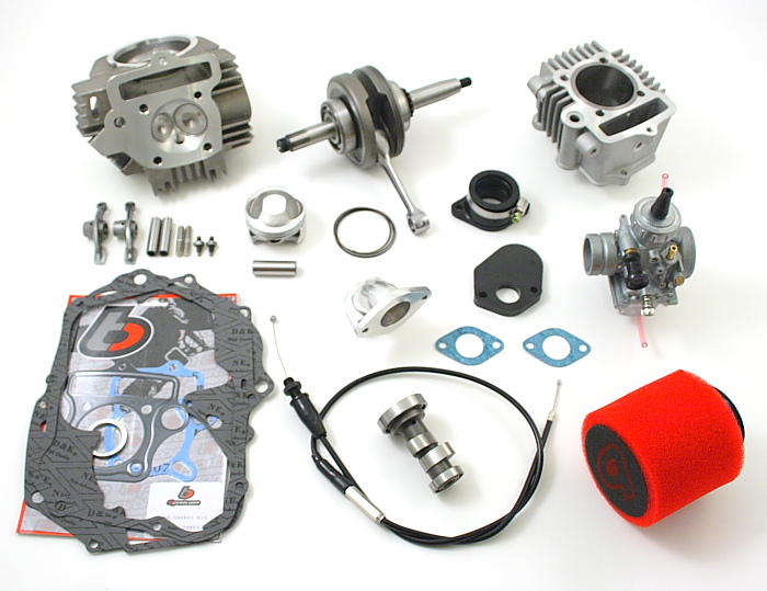

New Stroker 117cc kit for CRF50 with 30mm/23.5mm valves !
TBolt USA, LLC » Pit Bike Engine Parts » Big Bore and Stroker Kits » Trail Bikes Stroker kit 117CC

the pricing on just the heads , no cam is $219
only a 54mm /117cc piston is matched to this head
(for now)
this is a very exciting new product !

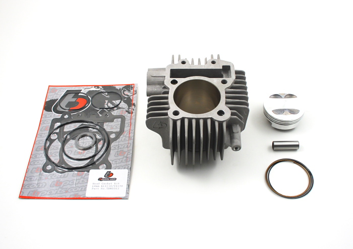

TB 165cc Bore kit for 4 valve heads
[TBW9057]
TBolt USA, LLC » TB Parts » KLX110 DRZ110 » TB 165cc Bore kit for 4 valve heads

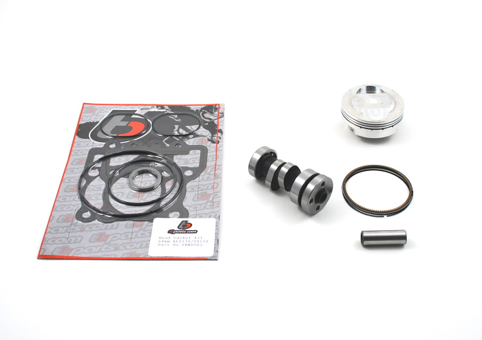

New more aggressive cams for V2 heads with matching pistons
TBolt USA, LLC » TB Parts » KLX110 DRZ110 » NEW TB cam kit for V2 race heads

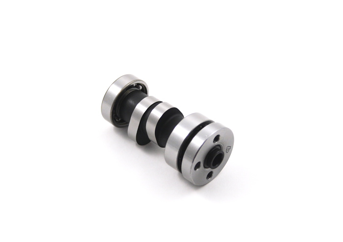

heres the new v2 more aggressive type cam listed online
Similar to the S35
(the original V2 cam was like an s25)
TBolt USA, LLC » Pit Bike Engine Parts » CAMS » NEW TB cam for V2 race heads
