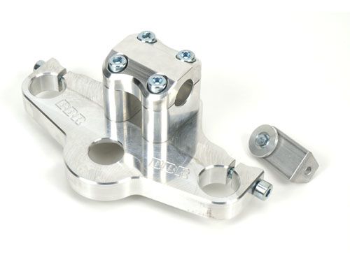

Can some one give me a little tutorial on shortening XR 70 forks? I need to drop the front of the kids bike 2" and cant with the stock top triple and I also feel that with the shorter amount of travel it would be like killing 2 birds with one stone. Maybe I'm wrong though.
This is a Road race bike only by the way.

you can cut the springs to reduce the travel but the best way is to get a BBR top clamp and then you can just raise the forks up in the clamp..like this

change the top clamp so you can keep the little travel you have .but find one that will let you slide the tubes up where you want them

this is what ya need

I appreciate the help but can some one tell me if I need to replace #5 with a spacer or add a spacer? If so how big and of what material? I want to shorten them 1"-2".
Also I thought of the triple clamp but the next move is a custom set of clubman style bars and the forks would get in the way. Plus I don't want to spend anymore money on this bike.

I would cut the springs just a tiny bit less than the height of the added spacer to even things out. Add a little bit of preload to the forks, but don't add the height of the spacer in preload if that makes sense. adjustable top clamp is your best bet. I hear you can run an XR80/100 top clamp for added adjustability, but you can only slide the fork tubes up like 0.5" before they hit the bars. I would dish out the cash for the BBR clamp.
