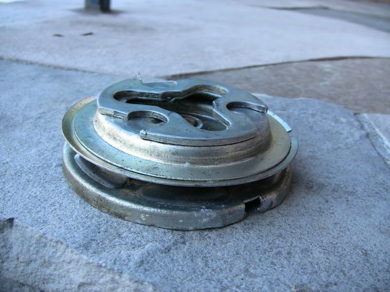

    The pulley is still available....$33... and is one of the culprits of the pull starter not working properly.
    Pulley shots.

    The pulley contains the spring which is not that hard to wind.

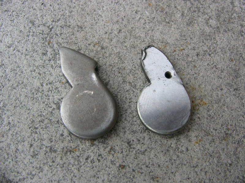

    Here is a pic of a new starter dog. There are 3 of them ......$8 each.
    Here is a worn one beside the new one. Notice the hole in the original one....

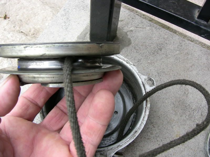

    The rope ties into the pulley and the spring does not have to be removed to change the rope if your rope breaks.
    The rope knot is tied into this bracket.

    The hole in the original dog is used for this clip. The new dogs do not have the hole so the clip can't be reused.
