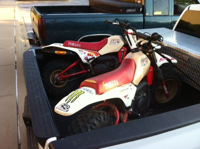

    I just found one of these on Craigslist for $550 last week, but when I called the guy he said he actually had TWO of them for sale!!! I jumped in the truck and bought them both for $1100. Both fire right up on the first kick and run pretty good. Plans are to get a FMF pipe and little things here and there for now. I'd like to get some wheels and tires like you 234wheeler sometime though, those look really good! These things are a BLAST to ride.
