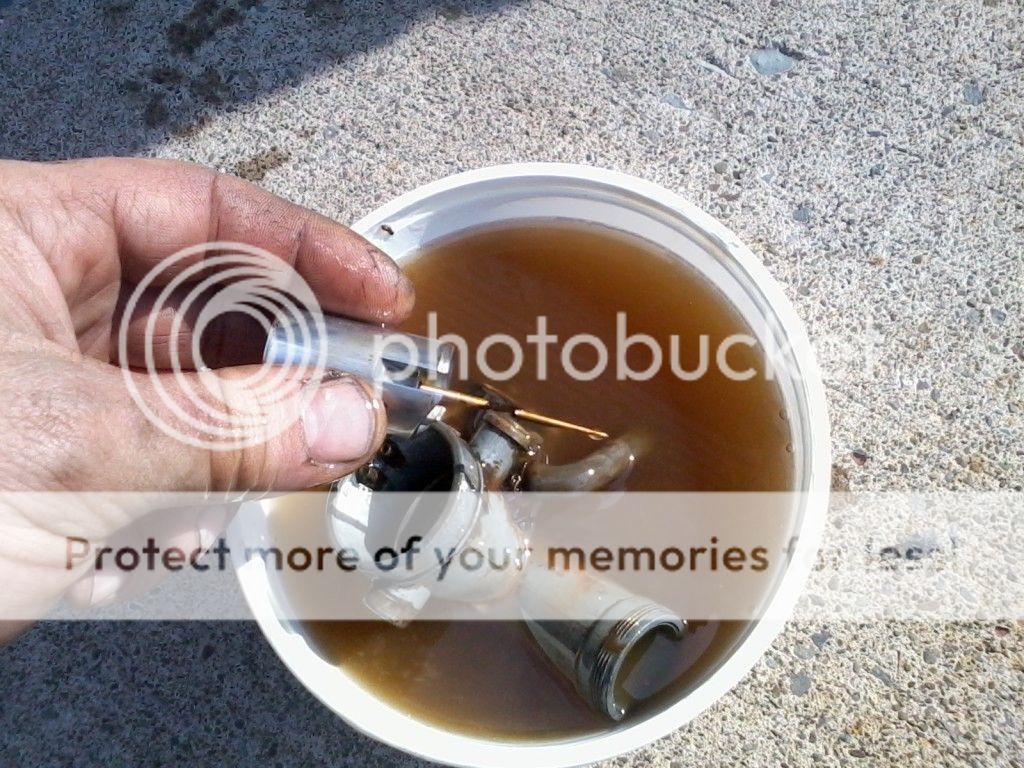

    For $29.95 you too could have owned this OEM Keihin PD 62B 1984 ATC200X carburetor. The weapon of choice for modest XR100 BBK builds, everywhere.
    The description read "Useable condition, for parts or rebuild. Slide is stuck down."
    We'll see about usable.

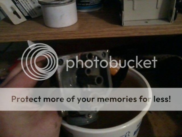

    The bowl screws had clearly not be disturbed, the bowl was good and locked in place - Good. I'd rather fight my own battles than repair the damage from someone else's ignorance anyday.
    A few healthy raps with the handle on my screwdriver knocked it loose to reveal:
    Death.
    Black tar and sludge in the bowl, not only is the slide stuck but so is the needle and float. The jets are unrecognizable studs, the fuel screw looks like a rivet with threads on it; every port is blocked, the only parts that move are the choke and the throttle cap.
    So, $29.95 plus $15 shipping (O, Canada.) = paperweight? Not a chance.

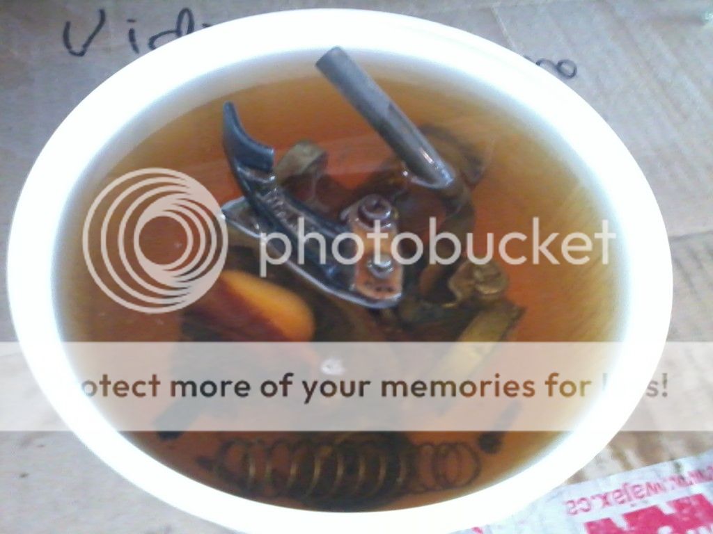

    Into the secret and mystical elixir to soak it goes.
    Double double toil and trouble... 45 min's in the soup and there's almost a creamy substance floating in the elixir.
    After 90 min's in the (margarine) cauldron, a little nudge with a popsicle stick on the base of the slide...
    and it pops right out.

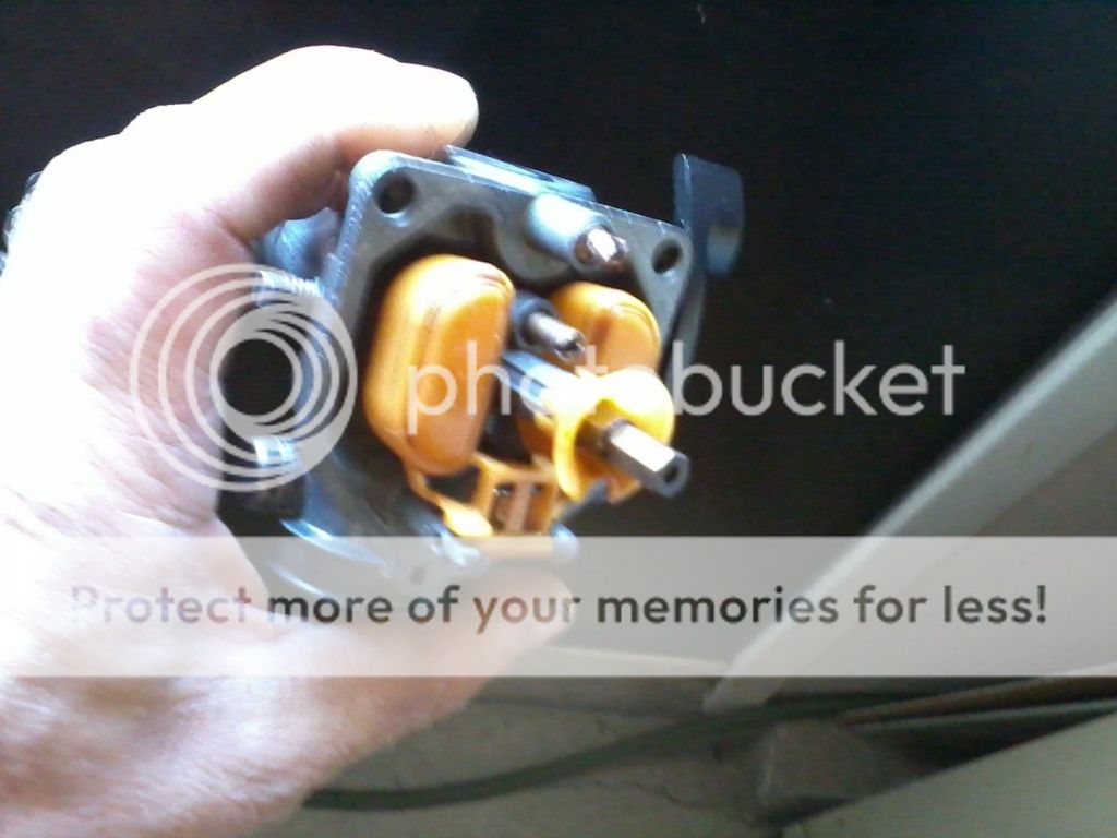

    4 hours in: the float and needle are freed from their prison, all of the ports are flowing though the jets are plugged solid; starting to look not to shabby.
    is twist the wrist too feel the
    bliss

    what are you using to soak it in just curious?

    Quote Originally Posted by ndubstuntz420 View Post
    He uses Pine Sol.....

    Quote Originally Posted by tmas View Post
    Spoiler.
    Bike RIPS with this carb installed (you'll need a slightly longer throttle cable (CR80R) too.).
    XR100 w TB 120BBK
    WB pipe
    Uni pod filter
    It's lean just off idle but should be tunable by relocating the clip (standard PD62B jets and needle, 108 main, 40 pilot).

    Amazing. I probably would have scrap piled that one after getting the float bowl off and seeing that. Did you replace the jets or did those come clean too after the soaking?

    Quote Originally Posted by Branyers View Post
    Had to give the pilot a poke, but the 'sol softened things up enough for pin to penetrate. I haven't finished jetting it yet (I have 6 bikes in the garage right now in various stages of repair), but it does run like a scalded cat (comparitively). I even reused the rubber bowl gasket and intake pipe O-ring.
