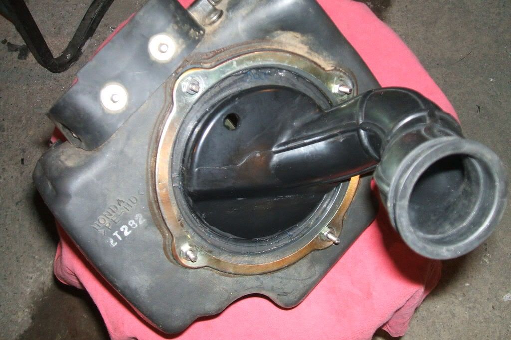

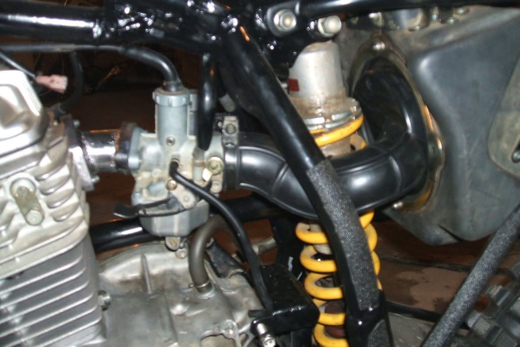

    Quote Originally Posted by zbbt
    yes it takes quite a bit of work, depends how you do it really, my hardest part i feel was customizing the airbox to re route it. that was a nightmare. other than that and remaking that back bracket though its not too bad. i would get the tlr 200 motor though next time
    On my cr/xr conversion, I use drz/klx air boot for air box. It all ready was proven on a few conversion build over a TT. I apologize for the poor pic. Their in now a heat insulator inbtween the carb and the intake. I used .250 plexy glass for mounting rings

    Sorry guys, I don't know how the hell that happen.. ^^
    Here it is.

    whoa thats good to know about the intake! are you talking klx125 or what bike specifically?
  12. #26
    gman's Avatar
    Apr 2008
    Pittsfield, Massachusetts
    412
    Re: Conversion Bike Thread
    Yup, the klx/drz 125 air boot. If remember correctly, all part numbers are the same through the years. It fits the carb perfectly. However, it's about a inch or so smaller than the cr air box.

    wow, that is amazing! my intake was a nightmare plastic welding and resealing the stock box.

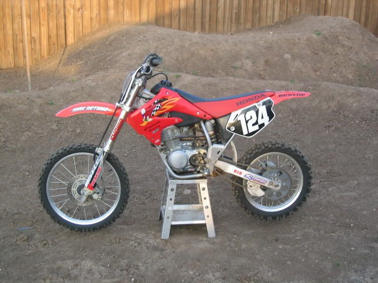

    Here's mine..
    Chip
    cwbride

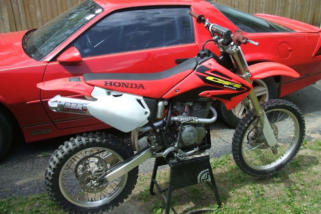

    Quote Originally Posted by xr70racer
    Wow, some really nice bikes on here. Really want to do an 85 front end on my bike. Heres my 2004 Crf100. Has a lot of mods. Motors got a bbr 120 kit, fmf pipe.
    I have a 06 rm 85 front end for sale.

    Quote Originally Posted by cwbride
    Here's mine..
    Chip
    thats sick. thats exactly what i want to make mine look like.
