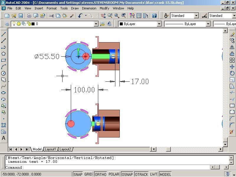

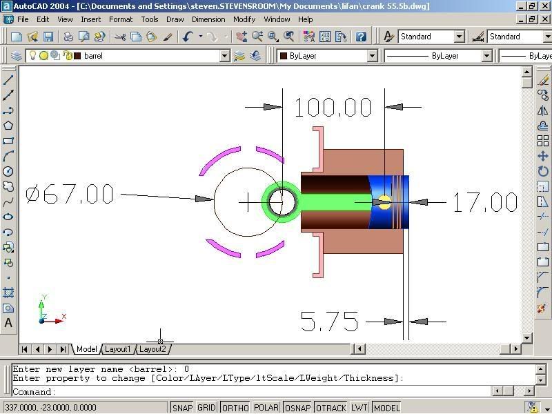

    about a year ago I started to do some comparison testing and get info, but not alot of people were helping and the threadcrapping just wore me out.
    The obivious differences are the piston pin, 13 gpx or 14 lifan for off the shelf pistons.
    Cylinder lenght, I think it is 68 and 78.
    The lenght of the rod is 100mm for most.
    Stroke are 54,55.5,57, and 59 and you can use offset pins also.
    Here are some pic of some model testing that I was doing, it represents my lifan 120 monster, 55.5 stroke, 100mm rod and 14 pin. Some claimed they had big bore kits and pistons for the 14mm pin, but when I plugged the numbers in piston pin center to deck height showed problems.
    I hope akunar has some pistons for my sons motor.
    IMG]http://i108.photobucket.com/albums/n6/chiribomb/55.jpg[/IMG]
    this one
    this one also
    another
    another
