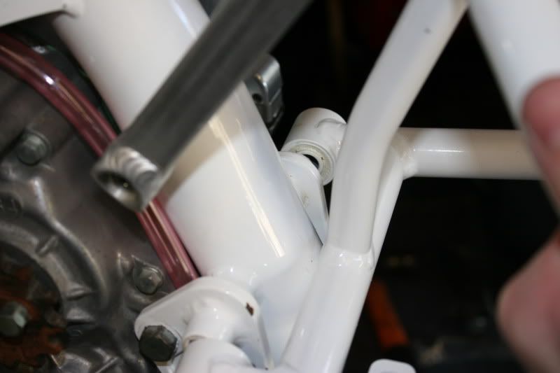

    ahh I see yeah I wouldnt touch the swinger as if you bend that section inwards it could pull the 2 mounting points inwards as well plus I wouldnt weaken the poor lil shwinger
    I would cut and weld in a piece because it doesnt look as if you only need like a 1/16th of an inch you need a fair amount of space in there
    Or a press might work as well but cutting and rewelding in a flat piece in there would be structuraly your best bet
    ya i agree with the swingarm..
    was thinking flatting it first if it dont work ill cut it..

    so i got a brand new five-o white frame well i go to put on my stock swingarm on and it doesnt want to mount up as the tub on the frame on the bottom is sticking out as in fat..
    what should i do?
    i dont wanna hammer it down as its new lol but i want my stock swingarm on..

    if you got the metal work skills then cut and plate the frame, but id be more incline to C-notch the swingarm

    easy fix , large C clamp and rounded block of hard wood (hehe i said hard wood), light pressure till it dimples the frame .
    better fix , cut out a patch in the area that hits , flip the cut out piece inside out weld in back in , grind it smooth , re paint , look factory .
    i've done this on a harley frame so an evo fit in a shovel head frame.
    nice build , is it for stock/mod class at mini moto sx ?????

    hey seth only read the first page but it was the same on my billetware... u either gotta weld and extend those 2 pivot joint things on the stock swinger.. or i believe a 70 swingarm will fit. dont hold me to that though

    I'd just dent the swinger with a hammer, but do a good job with it cause you need to remember with suspension that swing arm is going to be moving up and down. So Make sure you dent it enough that it won't rub on the frame when compressed.
