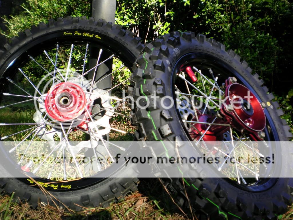

    If you want a 12/14 setup I might sell you my spares
    KX65 hubs with good bearings, pc'd red with hd spokes and rims, front STR Galfer Wave rotor, Brand new Dunlop 756's
    Have not run them since I bought them, rear wheel could use a little truing, has a slight hop, not bent
    I have a lot more pictures if you are interested
    $440 shipped, anything less and I would lose money. I'd rather keep for spares than lose on them.
    Finally I get to see what they look like,, did you still want to do that trade???

    Dang Gary, I thought I got dissed haha I sent you an email that day with like ten pics... You didnt get them?

    I hear you, yeah I re read your thread and realized you def dont want 12/14. Hey Gary, erase your quote of my picture so his thread isn't all junked up with a bigazz pic.
