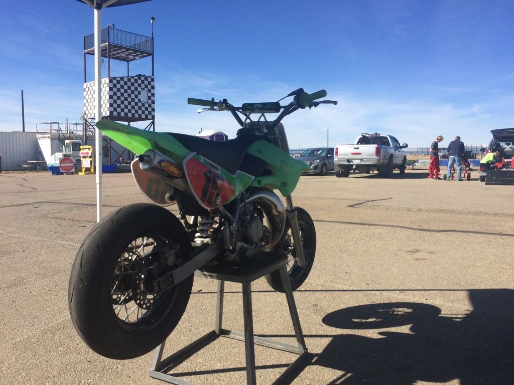

    Just wanted to post my mini fun for this year. I decided to buy my first mini last year and start racing with the local club here in Colorado. I bought a China Pirahana 190cc 4 valve 4 stroke. I paid $1500 for the bike and another $500 for wheels and tires and hit the race grid. The bike was fast but unreliable and the engine parts were extremely expensive and hard to come by. My season was just filled with bike fixing and frustration. I would not recommend any China bike for racing personally.
    I ended up selling the whole package to a guy for $1,000.
    This season I bought a used KX65 with a blown up motor for $500. Lots of guys in my race club run kx65's and win on them. We all must run 12" wheels and tires.
    I bought a set of China mag wheels for $250 and some Michelin tires made for a scooter that were supposed to be sticky and decent enough. I rebuilt the engine with a new bottom end. I kept the same top end because it looked good. The engine ran really well after the rebuild for the first couple of races. I changed out the top end and it blew up on me unfortunately. I did one race weekend on it and it ran great. I think that a clip for the wrist pin came loose after taking it apart. I put another top end in it and it blew again right away so damn time for a full rebuild. This time I had another guy build it for me and he installed an Athena overbore cylinder and piston.
    Engine is great now after some carb tweaking. Not that much stronger but a broader power band. I wouldn't really recommend it unless you tore up your cylinder like I did. It's good but $600 good maybe not.
    I tossed the mag wheels, they are not a good purchase in my opinion for the KX because the bearings are the wrong size, and they don't fit with the stock brakes... you can't even fit a rear brake because they are so wide. I got rid of them and went with a known KX65 plug and play wheel/tire combo that I would recommend form K&J. Also the Michelin tires were crap. If you are not racing they might be fine, definitely durable, but all the guys run sticky race tires in my club so that's the way to go and Mitus tires stick and last... they are awesome.
    I have Vforce 3 reeds, ProCircuit pipe, FMF silencer, Gen 2 SV 650 rear shock, stiffer front springs, 15W fork oil, and stock brakes. To make it as tall as possible I have a tall firm seat, and shorter linkages.
    Way too much money into this thing but it's so fun! I love the tight racing too and everybody in our club is fast.
    It's a great setup that I love riding. Two stroke mini is awesome in my opinion. I've raced a friends CRF150R and they are awesome also. I personally have more fun on a two stroke though I am a little faster on the four stroke. You have to ride the two stroke hard and precise to get the most out of it and it's a great feeling.
    I got a 3rd place finish at the last round and that was the best so far, not bad for second season I guess, I am still learning.
