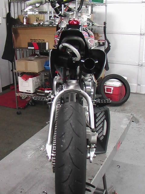

    here's a pic of a rear 601ss 120 on a 2.15x12

    matt thanks for the pic !! How's the side wall in relation to the tread look ? Does it look like it's a proper fit now ? As in is the side wall isn't so sucked in anymore ?

    For comparison, that's a TT91 120/80R12 on a 1.4" rim. Worked just fine for me.

    Why would you run a rear tire, that's too wide for the rim, in the front?
    How does it handle? Have you run a 100/90-12 front to compare too?

    I initially mounted the rear up front because I didn't have any fronts to toss on. : ) Turns out the profile is better with that larger tire on the narrow rim than a 100/90-12 on even a 1.6" rim, in my opinion. It steers a bit heavier at speed, but is also dead stable when swapping side to side at speed. I liked the handling, ran a 100/90-12 for a short period and went right back to the big boy, took a lot of the twitchyness out of the bike.

    I know I haven't even run one of the set ups before . But I don't see how a tire that looks way too wide for a rim will will properly handle and give you the proper input needed to ride the thing to it's full potential .
    In the 1st pic of your bike Josh , I would think the thing would ride and feel like it has a very low or flat tire unless you put in like 40 psi ??
    And please don't hate me for say'n this next part as I'm only think'n out loud !!!
    What you describe as , ??????? "swapping side to side at speed" ?????? scares me alot !!!! And if it were me and my bike and I felt those symptoms you describe ? I would have stayed off of the thing until I could of corrected the rim to tire profile first . But hey ...., that's just me ... I would have then gone for the suspension and lastly riding stlye . I'm gonna venture to guess now with your new set up and that all of your ducks are in a row , you should now notice that very minor inputs to the bars and minor body position weight shifts are much more noticeable as the bike reacts to them much more quickly and precisely ???

    What I meant was we had a section of track that had you going through a left-right-left chicane at a good clip. The larger tire acted as a bit of a damper, preventing head shake through that section compared to running a smaller unit.
    I haven't had an opportunity to run the new setup on a fast track yet, so I can't really compare it to the old setup. At low speed it feels great, the long swingarm makes rear slides very predictable.
