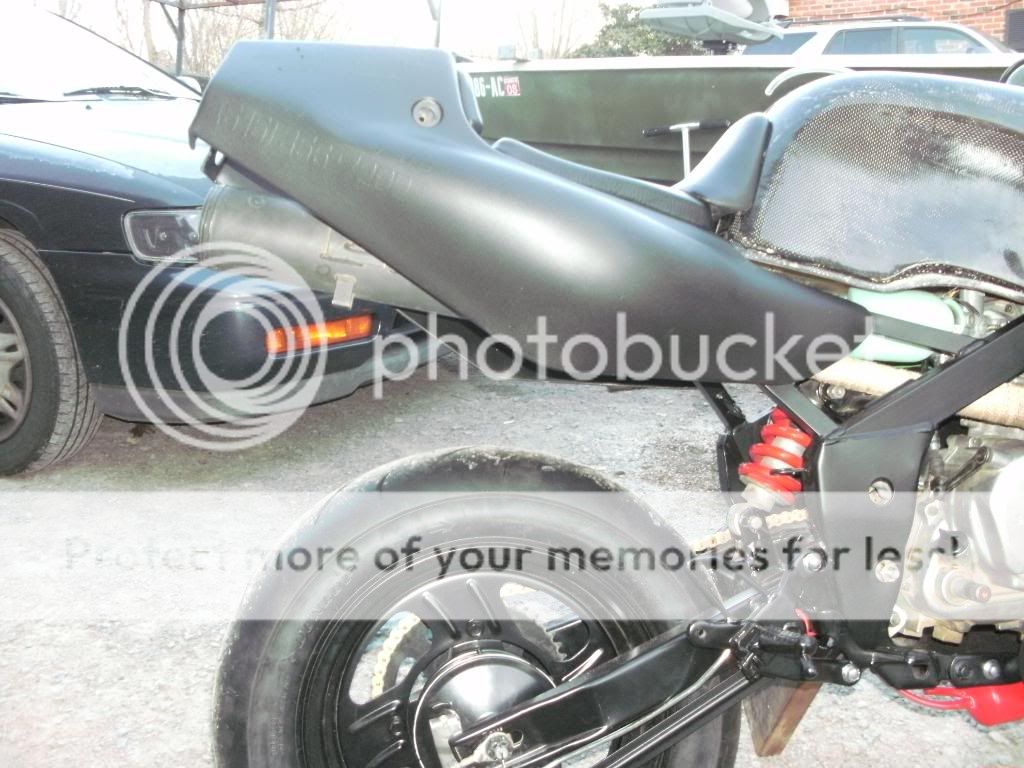

    ready2fight is correct the 3" over is was softened the rear,with The works shock you should be able to stiffen the rear,

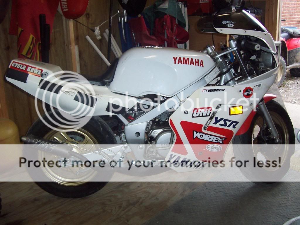

    as for more ride height I removed the rear shock mount and added a spacer then welded the shock mount to the spacer. I was able to raise the rear 1 - 1 1/2.here is a pic after I got the shock mounted
    here is a stock set up so you can see it definately raised the rear.
    good luck on your build, keep us posted
