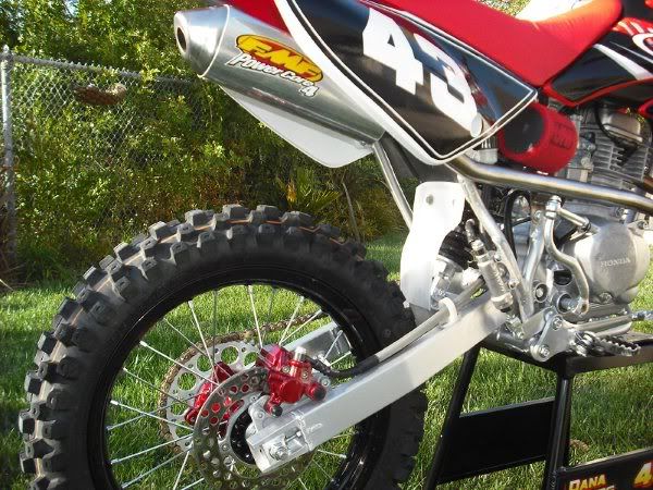

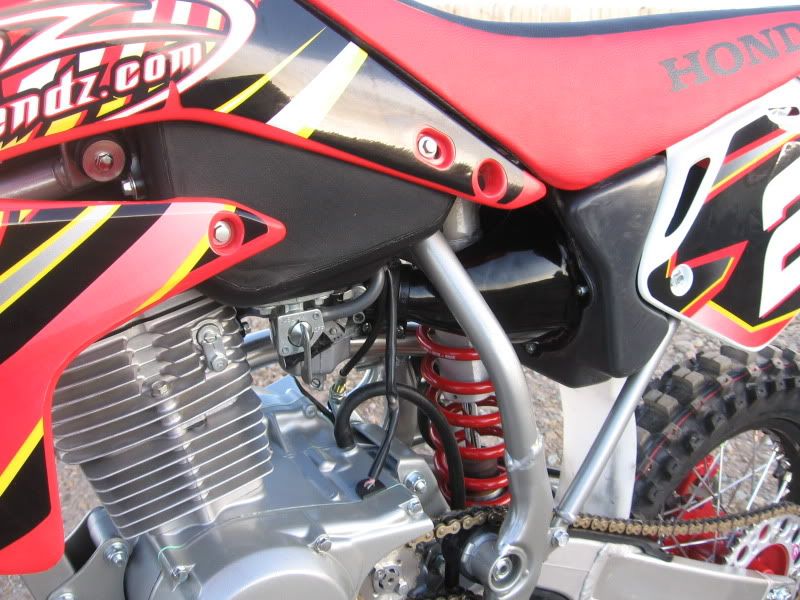

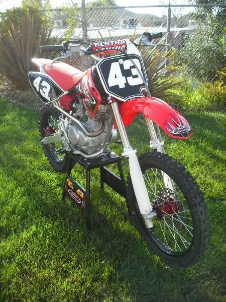

    Build a conversion! CR85/XR100, KLX125/KX85, TTR125/YZ85, etc.
    Here's a few pics of conversions I've built. By far, the most fun I've ever had on a mini.
    2003 CR85 chassis with 2006 CRF100 motor
    Modified 2006 CRF100 chassis with 1998 XR100 motor, custom, one-off swingarm
    Modified 2006 KLX125 chassis and motor with 2003 KX85 suspension, wheels, brakes, etc.
