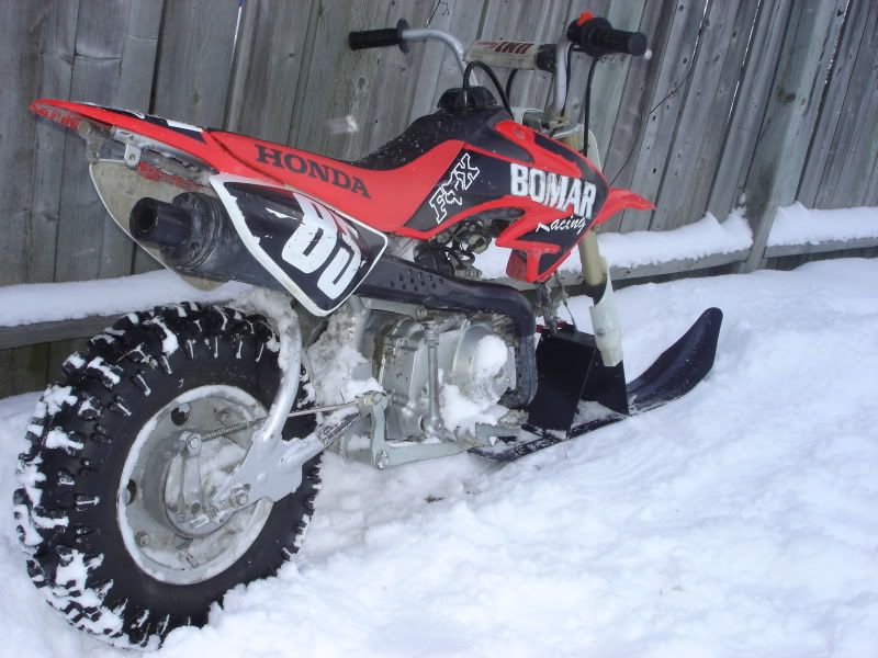

    Ya man you can do it just fine here is a pic of my winter set up

    Man, that's sick! Tell me that's a 4.00x8 tire?!

    Ya man they are awesome in the snow,I pulled the wheel as far back as i could to gain some clearance but they do get plugged up ion the mud

    That's awesome to hear! Sounds like my 4.00 street tires should fit then. Thanks alot for the pic and confirmation they should work!
