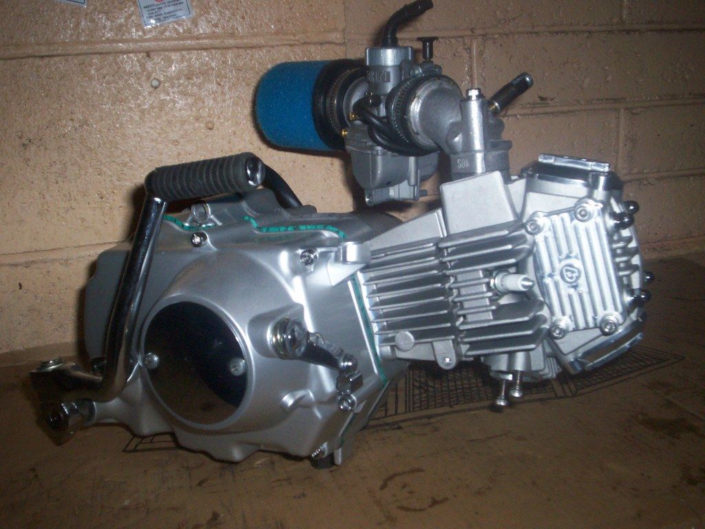

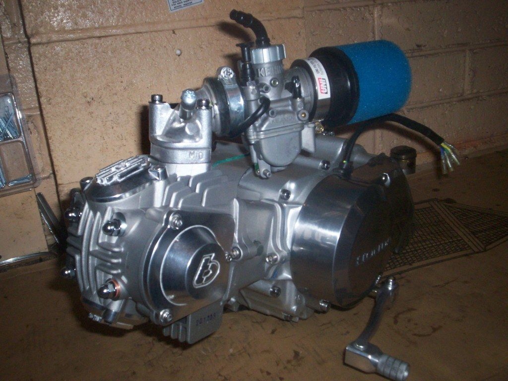

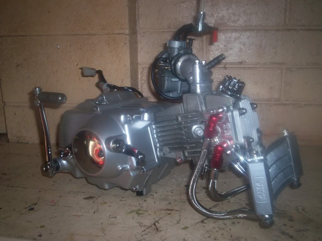

    hi all ,,new member here , from south tassie australia ..
    i got one of these kits a few weeks ago , and bolted it to a j1 block
    motors stats are ,,
    the v2 roller rocker head ,
    88 barrel with the stroker crank to take it to 108 cc
    pe24 carb ,," sitting on an asia concepts manifold at the moment ,, tbw0433 on the way .
    ahp 4 speed conversion
    manual tb clutch conversion
    tb billet clutch basket
    12v cdi kit
    only hassle i had was the thin " black " head gasket ..
    on reaching tdc i felt a resistance and then could see the cam cog " click over " so to speak ,,
    swapped back to a " stock " 88 composite gasket ,, and things are back to normal ,, any ideas ? .
    also , if the head is a take " copy " of the super + head ,, will the oil cooler bypass plate bolt on ? ,,, as i want to use this cooler ,,

    Oil cooler Plates will be out Soon too
