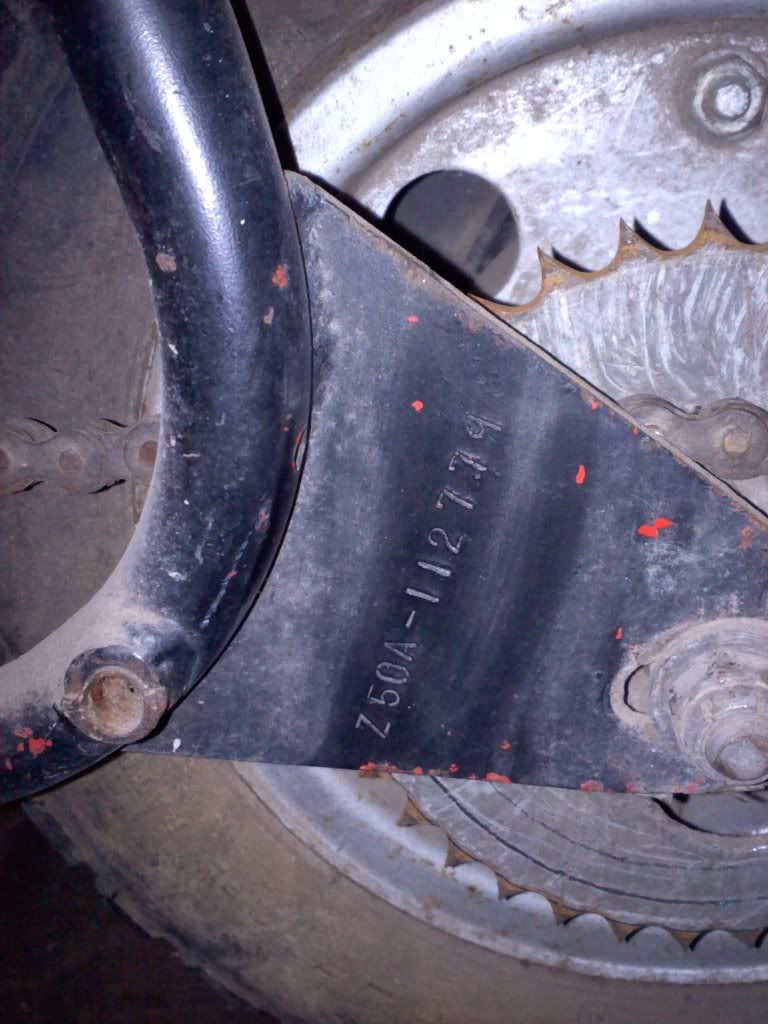

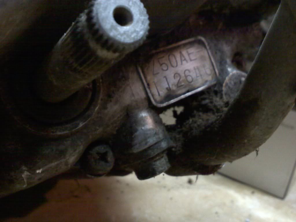

    frame and engine numbers!!
    now someone please tell me what they mean haha

    I believe that's a '68 Z50A-K0, according to the frame # decoder table and engine # decoder table, both found on this sticky:
    http://planetminis.com/f14/z50-ct70-...ces-94207.html
    Wow! I'm not a collector, but I think those are kind of rare, or something.
