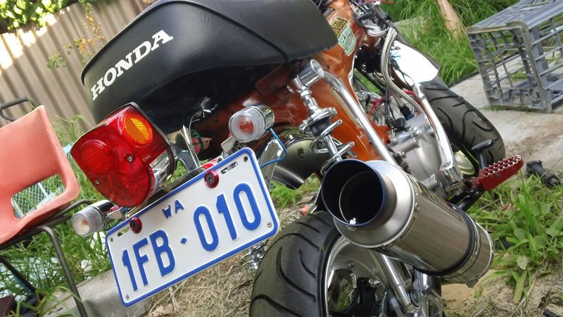

    Took so outside photos.. Still got a few things to do still.

    Quote Originally Posted by dezzie View Post
    What size rims are they width wise? I just bought the falcon copies off ebay, 12x4 rear and 12x3.3 front, tryin to figure out what size tyres ya have on yours, i know the take ones are made by maxxis apperently so i need help in a size to buy, any help mate? cheers!
    The rims are Takegawa's 3.5 and 3.75 so they say, but the lip width is much wider . the fronts are 4.25 and the rear is 4.48 from memory.. The maxxis tires are 110/60-12, good luck finding the maxxis tires in that size, they are not even listed on the maxxis website they might be only sold to takegawa and you have to buy direct from a dealer most likely

    I have yet to ride it, taking it to be inspected and get it licensed for the road in the coming days... Dont wanna loose my drivers license again for riding a unlicensed bike on the road.
    The shocks feel nice and firm and the front end feels so much better than the old gear, This bike should handle well, I use to give it a hard time in the dirt and was riding foot out 3rd pinned so its going to be a hoot with the new motor and sticky tires.

    Got the best phone call I've had in a long time... Paper work is sorted and the bike is now on the road and legal.
