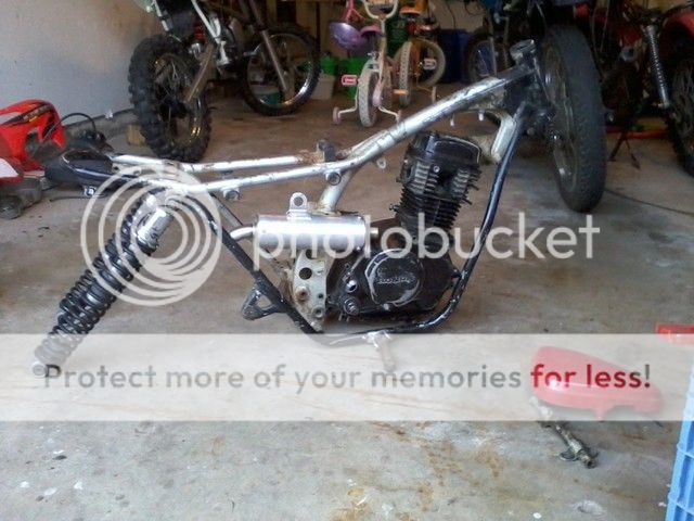

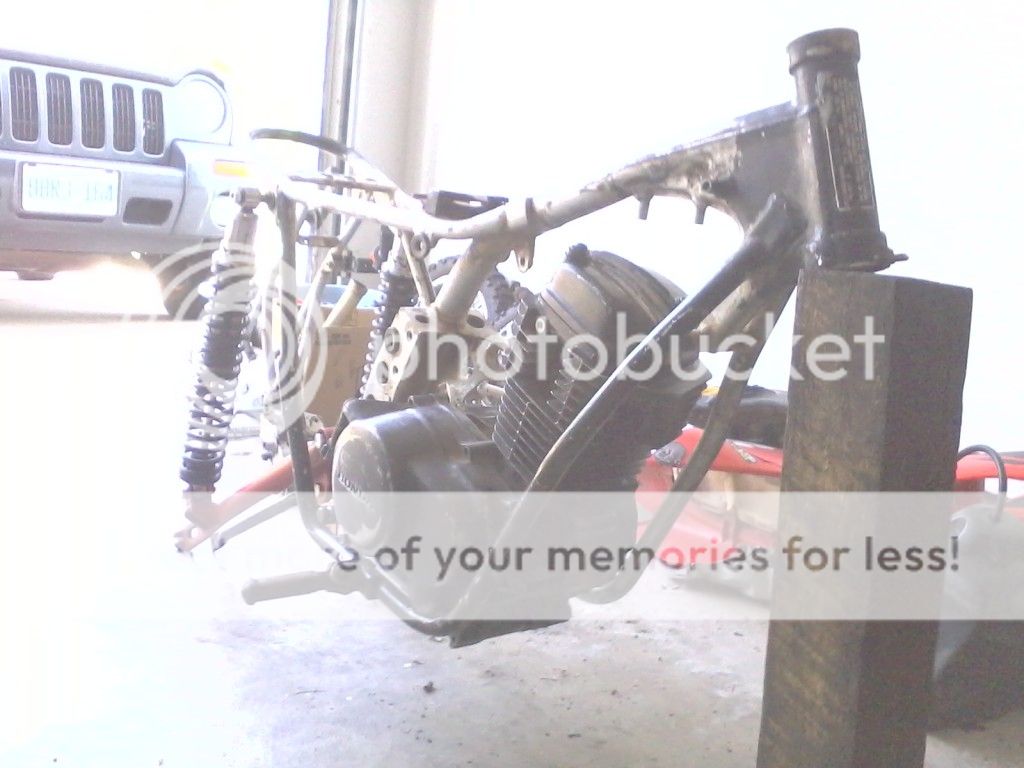

    • The first cut is the deepest; removed the sl70 underside engine mount bracket to allow the XR to sit lower in the frame.
    • Lots of room for the exhaust to come out between the spars.
    • Intake will be snug, will most likely end up reworking an early XR100 intake or maybe swap out the carb for a PE24 and do an angle mount.
    • Dropped the CR80 pro circuit silencer on just to have a quick look, I am going to be cutting up the stock pipe (reusing the flange only) but don't know whether to pattern it (going with larger diameter pipe) and have it dump in the current position or go with a somewhat easier to fab down pipe.
    • Brake lever will be cute. Already fighting for real estate with the lower rear engine mount. The engine mount may be sacrificed as I plan on suspending the engine with the peg mount bosses and front 'brace'.

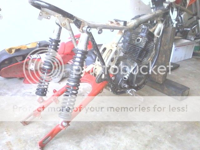

    • XL185 rear shocks mocked up, will stretch an early XL 100 swinger. Not getting any younger and central Ontario's pot holes aren't getting any smaller.
    Gotta slow down with the recip saw for now, still need to map out the position of the SL's countershaft sprocket, I'll be using that point for datum.

    Shiny red swingarm courtesy of Terry @ Firepowerminis
    It's gonna be mean.
