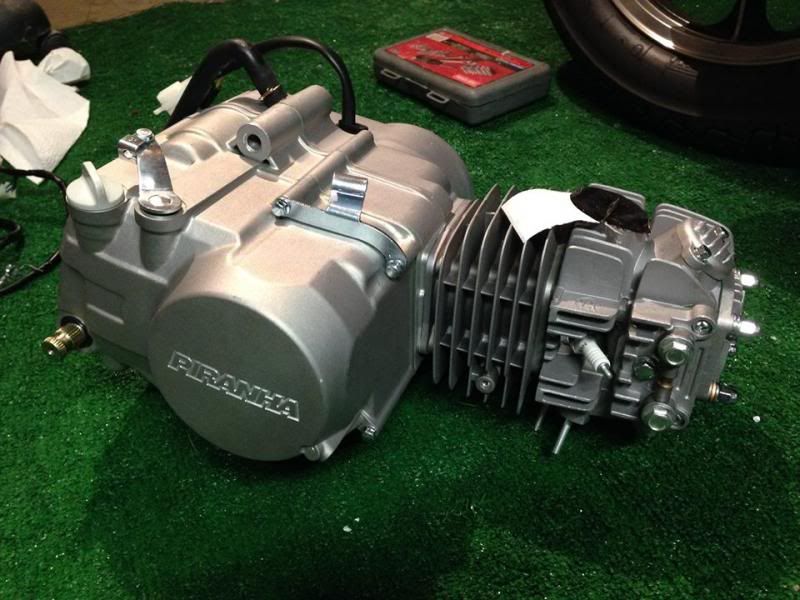

    Two questions here.
    Anyone know what size chain fits stock front sprocket?
    Got my sexy motor in and cant exactly tell.
    Its 16T and Id like to use it....
    So Im also trying to figure out what the equivalent gearing of 17/35 is with a 16T front. So 17/35 = 16/?
    Thanks for your help!

    I recall the last couple off new ones coming with 428 pitch 16t sprockets.
    i personally like 17/30 on a 10" wheeled z50,or 16/28.

    Thanks! Yeah it appears to be 428 and it has 16t.
    So one tooth up front equals two out back?
    Does that reciprocity continue on in definitely or at least for a while?
