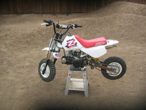

    It can be done but it's a bit of work. I have a 95 Z50 with Sik50's forks and a custom swingarm/mono shock setup using the original 8" wheels. I machined down the front hub instead of messing with the triple clamps to fit the wheel. Let me know if you have any other questions.
    Here is a picture...

    nw this is what im talking about! The bike looks sick. So you didnt touch the fork setup at all? how much did you have to take off the hub? did you only shave it on the brake side or did you have to take it off both sides. the other problem i was seeing when i was trying to fit it up was that the tire comes really close to rubbin the forks. I know your runnin the stock tire and maybe thats why you dont have this issue, but with the 4.80x8 snow tires they are a really tight fit. what is the rear setup you have? where did the shock and swingarm come from?
  14. #14
    arlindsay1992's Avatar
    Mar 2006
    Northern Virginia
    4,656
    That bike has a Yamaha R1 shock with a custom swingarm. I don't know any more than that but you're right, that's a tricked out bike.

    We machined about about 9/16" off the brake side. I also took about 1/4" off the other side but that was not necessary. I also had had to remove some material off the lower fork leg to allow the brake arm to move freely up and down. I wanted to install some of the snow hogs/shredder tires on this bike but I'm not sure they would fit. The swingarm is custom and the shock is from a Yamaha R1. Very fun bike to ride.
