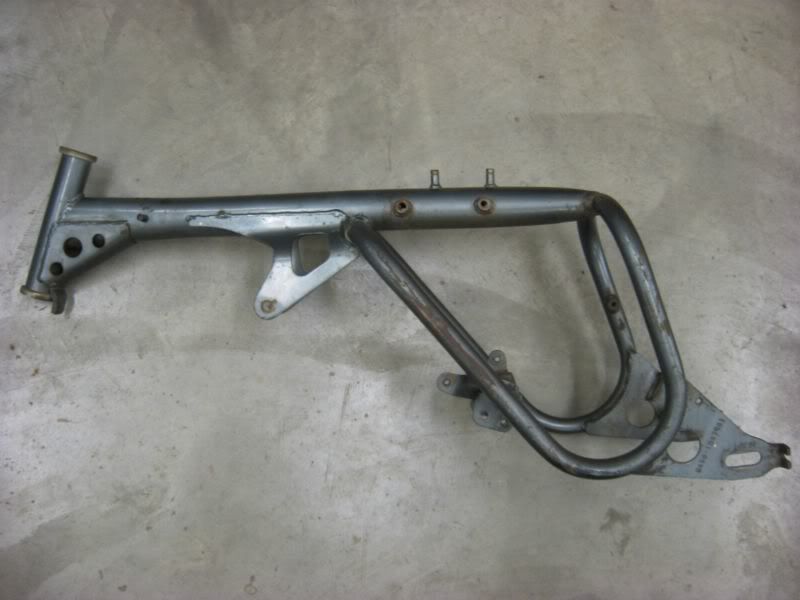

Just found the answer to my own question in the link below. To bad the pics of 3UP's are not there. Here is a pic of a QA frame & below is an explanation on what has to be done.
http://planetminis.com/forums/z50-ct70-jdm-monkeybikes/15628-qa50-change-over.html
New top motor mounts need to be fabbed as does the right rear. The left rear can stay and by using it the chain lines up perfectly,as does a CRF sprocket cover.
